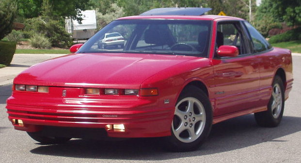

Ah, yes, my 1992 Oldsmobile Cutlass Supreme SL... a wonderful edition to the stable after wrecking a very clean 1989 Chevrolet Beretta GT in late December of 2000. I found the Cutlass at a local used-car dealership and snatched it for cheap. Like all used cars, it need some serious cleaning and a few maintenance items had to be dealt with, but it runs clean and well.
Drooling for the open road; and stopping for nothing but for refills and pit-stops.  Just the way I like it...
It has the all standard equipment and then some... especially being from the more refined side of GM. Along with the 3.4 liter DOHC V6 and a four speed automatic transmission with overdrive, the car has the essentials: power windows, power dock locks, power mirrors, cruise control, 6-speaker surround with AM/FM CD deck with steering wheel controls, automatic climate control, factory fog lights, remote keyless entry and 16" saw-blade Aluminum wheels.

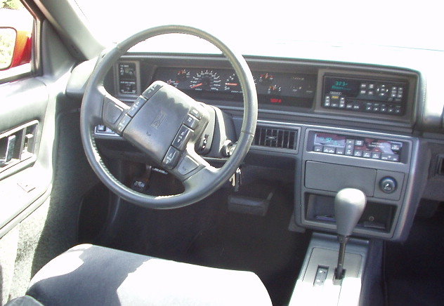

The instrament panel is very easy to read, since only the major four gages include oil pressure, water tempreture, voltage, and fuel tank capacity.  Along with a good size tachometer and speedometer, this setup has a lot of potential to be updated and accessorized.  Nothing is far out of reach and the readout for the push-button climate control are accurate.

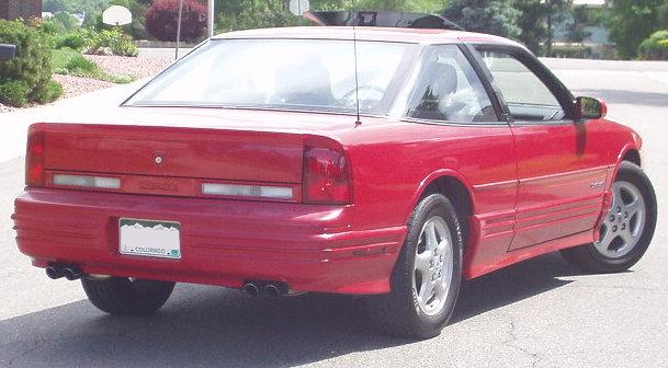

For being a ten year old car, it doesn't look bad at all.  Now grantid these pictures don't show all detail, it's obvious that the car is not perfect.  There is some oxidation of the clear coat in some spots and the entire front end is chiped up from rocks and gravel.  There are a handful of door dings and twice as many scratches in the paint, but that doesn't matter to me too much.  I just hate it when I come out and find another one after parking in a grocery lot twenty feet away from the rest of the crowd.  How's that possible!?!?  But nonetheless, kickin' the crap out of your driving opponent... now that matters.
As the months moved on, I added some other equipment to call it mine. My first move was to add the 16" 5-spoke Cutlass convertible wheels to the car. With finding straight rims at a local junkyard, the overall cost was kept down to a minimum. After collecting a full set, I had them sandblasted and refinished through Keystone Inc. Wrapped around with some new Phantom HRX's (P225/60-R16 97H), the car looks very sharp with the new set of rubber. Next I had a sunroof put in by a company called Jazz It Up, located in south Denver. It really helped me out, especially for all those sunny days, and keeping the interior cool during the summer. The last major appearance modification was that I added on the Cutlass convertible rear spoiler and light fixtures. Once installed, the car had a more 'sporty' image for being a two door coupe.

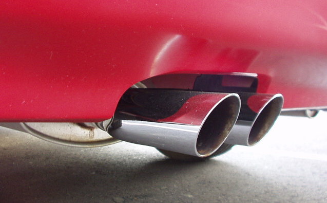

But unlike the imports of today, appearance is nothing compared to whats moving the sucker. I personally have been taking care of the drive-train and have been able to squeeze a little more power out of the engine not by supercharging (but which is a current project at the moment) or high volatile Nitrous Oxide, but more of the little things over looked by many common motorists. Along with some AC Delco Rapid Fire spark plugs, and a set of Magnecor 8.5mm plug wires, fuel economy and power has been increased by about 5 hp. I've placed in a K&N drop-in filter for more cool air from the airbox. Also, the stock mufflers have been removed to remover unwanted excess back-pressure, and a pair of Flowmaster Turbo II muffler have been installed. The straight-through mufflers give the exhaust note a good pur when sitting at a street light. As like all gearheads, small minor performance parts are on the way, and I'll fill you in when that happens; but don't hold your breath to find anything big.
The driver side exhaust tip; the chrome accents the vehicle really well.

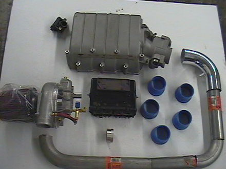

The deserted research project at RSM Racing:
the entire 3.4 liter supercharger setup.
It would inlcude upper intake manifold,
reprogramed ECM/PCM, Mass Air Flow sensor,
stainless steel piping / rubber gaskets and
 the Vortech supercharger (est. 9 - 15psi boost).

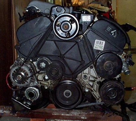

The passenger side view of the 3.4 liter DOHC V6. If you start at the top and follow the serpentine belt clockwise: power steering pump, water pump, A/C compressor, crank pulley, belt tension pulley, and the alternator. Now with the engine out, the alternator doesn't look that big a pain to remove...
